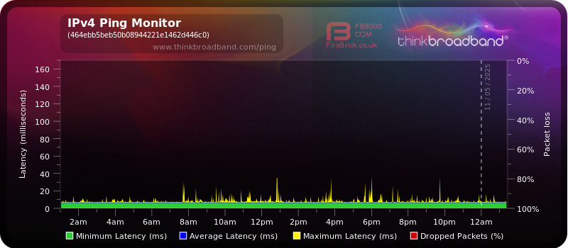

Not really a problem, more an observation, but something slightly odd seems to have happened with the upgrade.
My BQM trace from last Friday:
Today:
That increased ping (yellow) usually means more congestion, could the new kit be picking less than ideal routing?
Possible, Bill. Let support have the images so they can take a look at it. (Fwiw, my pings are slightly lower.)
I'll leave it for a day or so in case it settles down (may not be related to the upgrade), but will do.
It's not actually causing me any grief, and I'd guess support might still have other things on their mind :eek4:

Although I can browse most sites as normal there are a couple that seem to be consistently slow. My pings are not normal though, they were consistent between 30>35 but am seeing a lot of spikes at the moment. Have attached a TBB graph, have also had RouterStats on some of the time and the pings are showing up fairly erratic on there as well.
Not too keen on messing about much on this machine at the moment as it on it's last legs and VERY temperamental now. Should get my new machine soon  :fingers: then I can stop living on a knife edge  ;D
