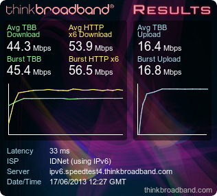

All has been quiet... Thankfully.
Have achieved 256 hours continuous uptime, a first in ages!!!! And finally, this evening, following a spec request from iDNet to BT today, to correct my upstream SNR, things are back to normal.
It has only taken four months of trial, error, anger, frustration, contempt and ultimately, persistence and the problem is now resolved.
I think we can close this thread now. PHEW!
;D
