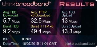

With the tbb speedtester I'm seeing up to ~50% slowdown for single-thread tests, but the 6-thread ones are normal:
No problems otherwise.
How odd and that was not that long before I tested mine.
Iirc a slower single-thread test indicates some congestion somewhere, but unless it's severe it won't show on a multithread one.
Not sure but I think speedtest.net uses multithread- if I've got that right then your result and mine aren't incompatible.

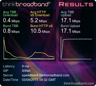

Well it seems to be happening again today  :( : -

I wondered a bit earlier if it was, but my result wasn't conclusive:
