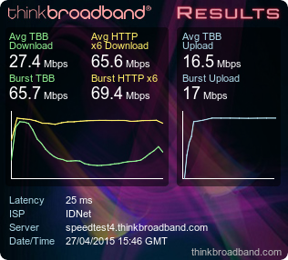

Not good... didn't affect browsing etc too much, but the indicated congestion also showed up on a tbb speedtest:
The low single single-thread speed compared to the six-thread is indicative of congestion somewhere: Link.
